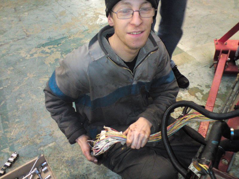

Wiring Ninja has cracked 61 from 65 wires so far Ninja
Posted 14th Jan 2010 at 23:33
Post #132
Sat on a sofa in the middle of my industrial unit LOL

done a handful now, they're all the same in principle on these French cars, helps with the later cars that most of the wires are numbered and use the same numbering principle across the 06 ranges Smile
I've also helped do two 1.6 16v Vitara FI engines into 1000 and 1300cc carbed Suzuki SJ's, Jap wiring is nuts Crazy

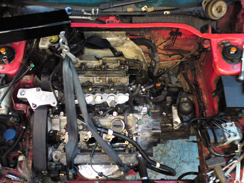

Been trial fitting the engine and box. It is going to sit about 2 to 3 inches further back than Carl's. Although this will mean more cutting of the subframe it will help the weight distribution.
Anyway fair way to go yet...

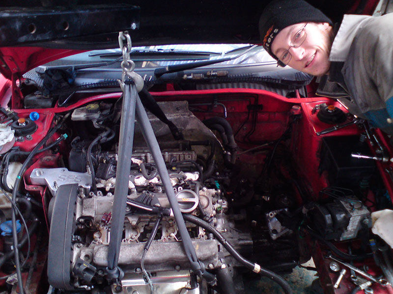

In the middle of the trial fitting marathon (it went in and out about 15 times...)
SES ally top mount kit
Bonnet shuts! Yay!
The difference between a shit pattern part cat and what mine should have looked like. (chin up CUJ)
Wiring wizard - shimmy you need...
Finally swinging freely on its top mounts with no driveshaft, exhaust or diff clouting.
Posted 17th Jan 2010 at 22:02

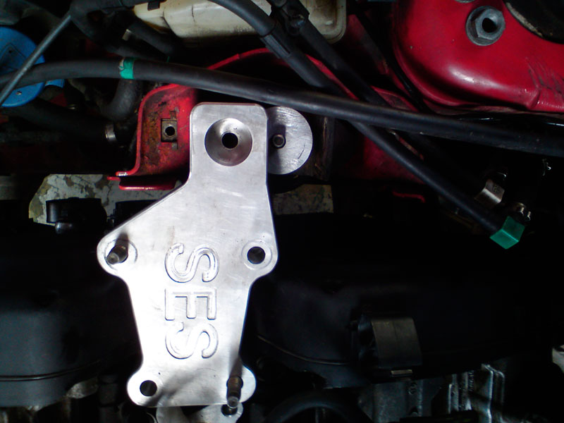

Its from a guy on ebay. Would make your engine sit a lot further back in the bay - the subframe on mine will have had a lot more modification than yours. Will post pics in the future when it is welded.
Ebay Link Smile
Posted 17th Jan 2010 at 23:45
Post #148
Fair play that mount looks awesome!
The shiny-ness makes me want to do the conversion just for that LOL Nice to see you have retained the crossmember also chaps Thumbs up

what gearbox mount is that?
Posted 18th Jan 2010 at 00:32
Post #150
standard 306 mount, shiny bit ias just a replacement bracket for the 406 gearbox as it didnt come with it, its stamped 96 - 2 years older than the donor. Had to come from France as well!LOL
It has now been modified to bring the gearbox end up about 10mm over standard. Also dropping the front of the subframe by about 6mm. The big problem is getting decent driveshaft clearance on the subframe - the diff and exhaust is easy enough as you can remove/replace metal, but the driveshafts foul on the wishbone mounts which can't be cut. The top mount will also be spaced up by about 5mm. Still fits under the bonnet Smile
