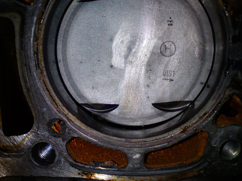

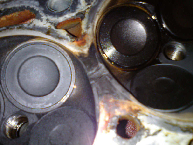

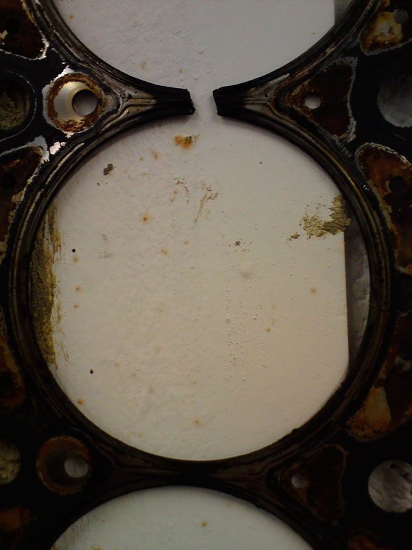

Small update.
The GTi6 engine was fairly fubar'd. Head gasket had a pretty large hole (biggest Mei has ever seen - sheltered life Whistle) in it between the cylinders. One piston has very bad wear on the edge and there is about a 0.5mm deep groove in the head. Not sure if it can be saved tbh. Shame as its fine otherwise and the valves are all good. Any idea if it can be filled and skimmed?
Crank and camshafts on ebay soon...

Good effort on the headgasket, will be watching this project as always wanted to know whats involved with the conversion.
Is the piston above a gti6 one? It looks dished in the pic and the ones i have seen are flat top.

Yes its a flat top GTi6 piston - dodgy mobile photo i'm afraid.

that gasket is like fatty's leg but!
