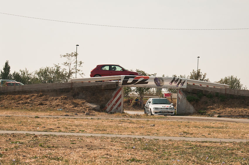

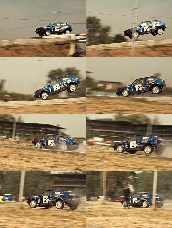

However the usual "sump breaker" is a track where even higher and much stiffer cars have broken their sumps Smile Also the other tracks we use are not so smooth and in good conditions.
Here are a few photos:
http://store.picbg.net/pubpic/F9/64/c275a2699c89f964.jpg
http://store.picbg.net/pubpic/2B/48/47ec7a9690f02b48.jpg
