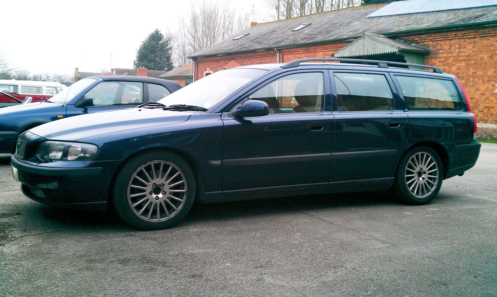

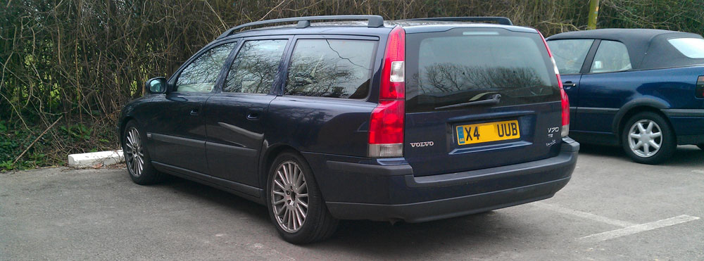

Quick update:
Had mostly cosmetic stuff done - new number plates, boot load cover from scrappy and a set of Volvo 17" Tethys alloys that I got cheapy cheap off ebay. Loads better condition than the old ones which will probably be kept for winter or track tyres.
Front wishbones were polybushed, new engine mount and discovered it will need a new offside driveshaft (fell apart twice). I've also found that swapping the Avon ZV5s to the rear and putting the Michelin PS3s on the front has made it loads nicer to drive.
Had a few issues, but nothing major yet. It gets tailgated more than any other car i've owned, doesn't really corner with STC on and will easily straight line most things, Clio 182/Boxster etc etc. Fun until you come to a corner! With some luck Curtis will have built the ASTs for it next week. He's been a bit busy and i'm not top of the tree. If this thing ever handles it will be a decent, practical weapon. Going to be a struggle though....
Oh and it only weighs (book) 1485kg. Quite a bit less than the 1800 I thought. Big grin
Posted 6th Mar 2011 at 02:31

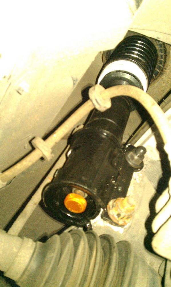

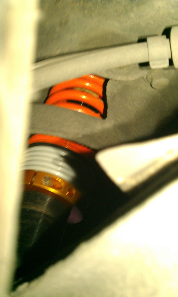

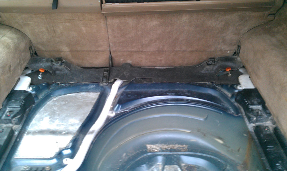

Back from AST very shortly. Nearside rear suspension has massive camber compared to the other: -3.5 versus -1.5. Think there is something bent in there considering that had the flattened alloy too.
T5D5 guys are going to read the codes for nowt so its just the window and whatever that throws up.
Happy days Meh

Orange Nipples!!

Mmm, nicer wheels Cool

I wait the "My AST's are broken thread" LOL
Why not wrap the car in AST orange?? Smile Would look cool as hell (for a Volvo)

is it the light conditions, or have you cleaned it?
