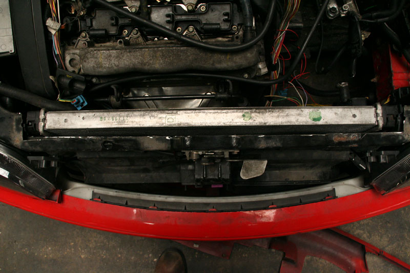

Radiator in place, fan + shroud chopped a lot, slam panel also chopped quite a lot as its a 406 rad (its new and I can't afford another one), front bumper and headlights also on.

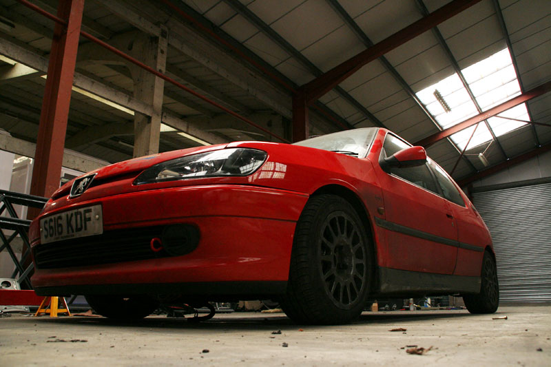

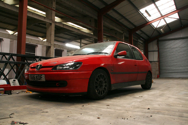

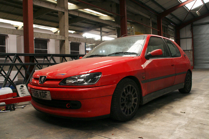

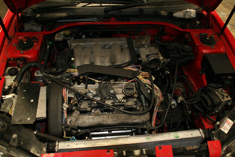

A few photos:
Yes it needs a good clean and yes there is still a PAS pipe hanging off the bottom. Engine bay is being tidied up this morning as its a mess. Smile
Seems to sit at the same height as before, amazing considering the 700kg extra on board Roll eyes

slam panel is still double skinned, only joined at the front edge only for the time being, looks easy enough to add some sheet metal into the gap at the back to stiffen it back up a bit, not that it's particularly weak at the moment anyway.
I started looking at moving the ecu across the engine bay to sit in the original battery box earlier whilst Adam was getting extreemely frustrated with the interior Ninja
I need to source some lengths of appropriately coloured wiring to extend the injector coilpack and Evap solenoid wiring as well as half a dozen ecu switching wires from the two relays, nothing difficult, just time consuming Smile

Why did the slam panel need chopping?
Also have you not looked at running a twin fan set up or is the one fan adequate at cooling a v6?
Answers are probably in the 15 pages but not going to have a look.
Posted 21st Feb 2010 at 22:07
Post #291
No they aren't in the last 15 pages. No idea if the one will be enough yet - it just doesn't involve any wiring changes at the moment and i've probably sold the 406 fans.
The slam panel needed the chop as the 406 rad is too tall to fit under it. As its new, slam panels are easy to come by/cheap and I can't afford a VR6 / 407 one its stopping there. Smile
