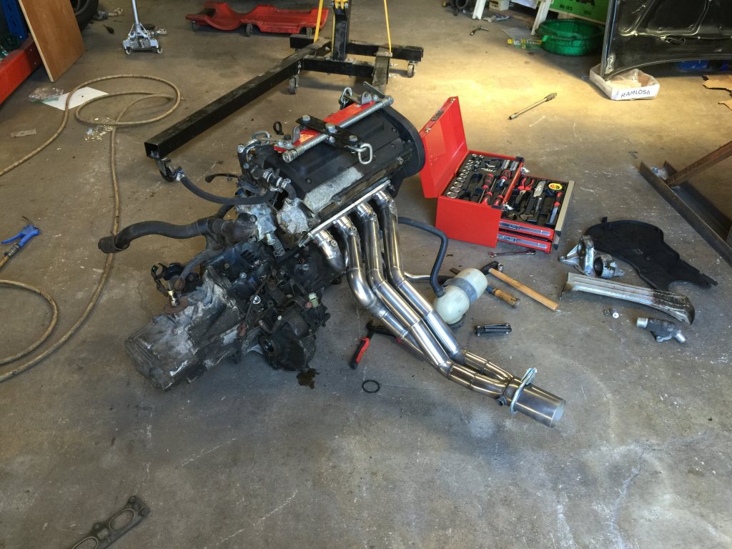

Post #357
Posted 5th Jan 2019 at 18:14

That’s cheating having the gearbox off

Post #359
Lol last time I had the gearbox on with a long punch was able to knock the pin out the arm
