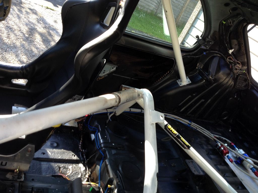

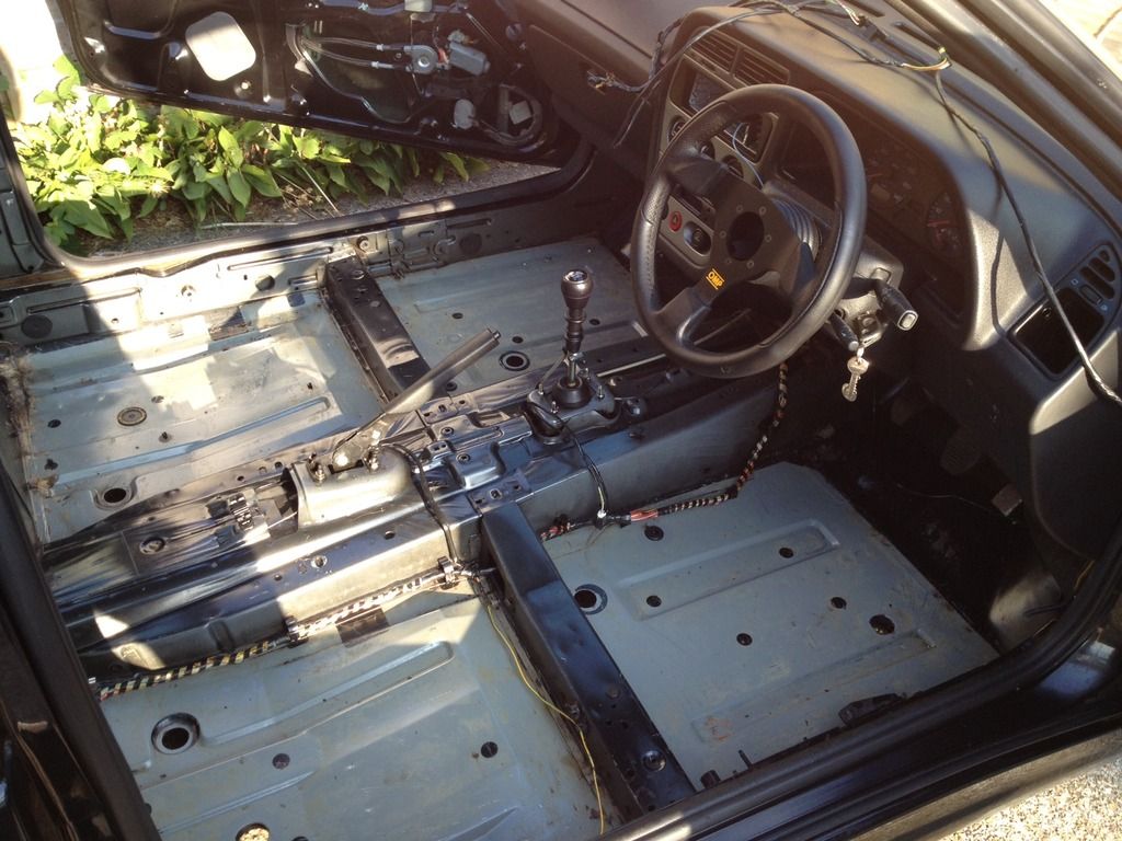

Work begins, first removing cage

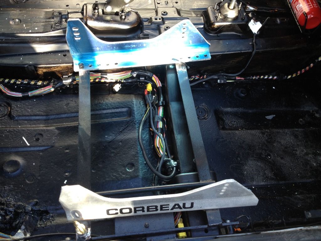

Bucket seat out, frame was fixed with 3 bolts and a zip tie and was p**sed so gonna weld the seat frame in nice and square

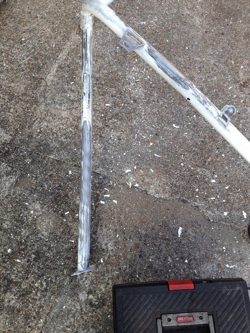

Started sanding down cage

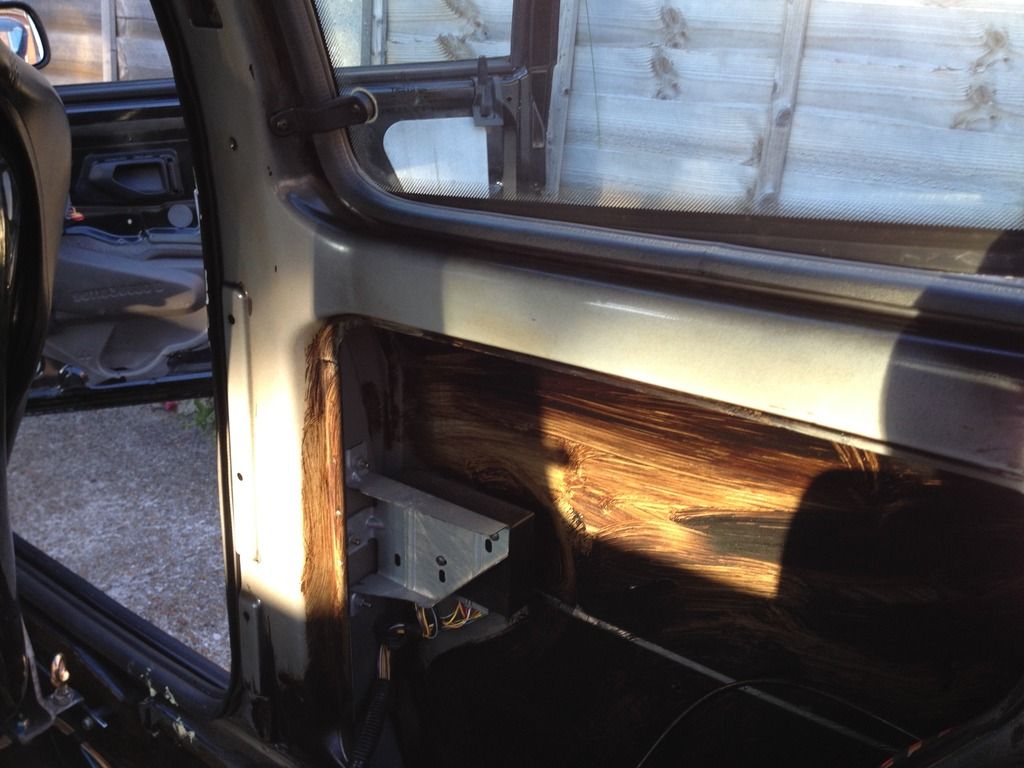

I'm going to spray the cage black along with the rest of the interior, which first had to be stripped of sticky bitumen underseal type paint that had been applied, everywhere.

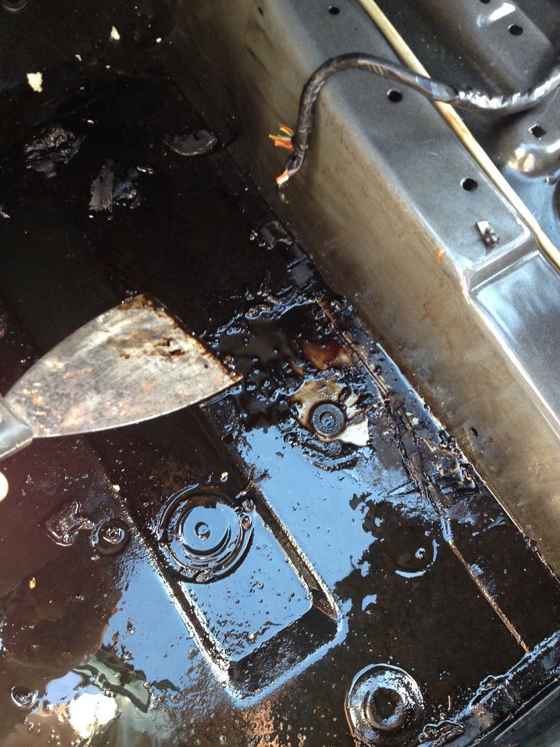

Started here, note the differnce between the clean bits and the deep mahogany of the underseal LOL
The rest took a Saturday, several evenings, 4 litres of white spirit, 10 old T-shirts, a lot of sweat and a sh!t load of patience
Next to tackle the floor insulation in the front by soaking it in white spirit to soften it up then scrape and chisel off
looks a bit like burnt donner meat
The result

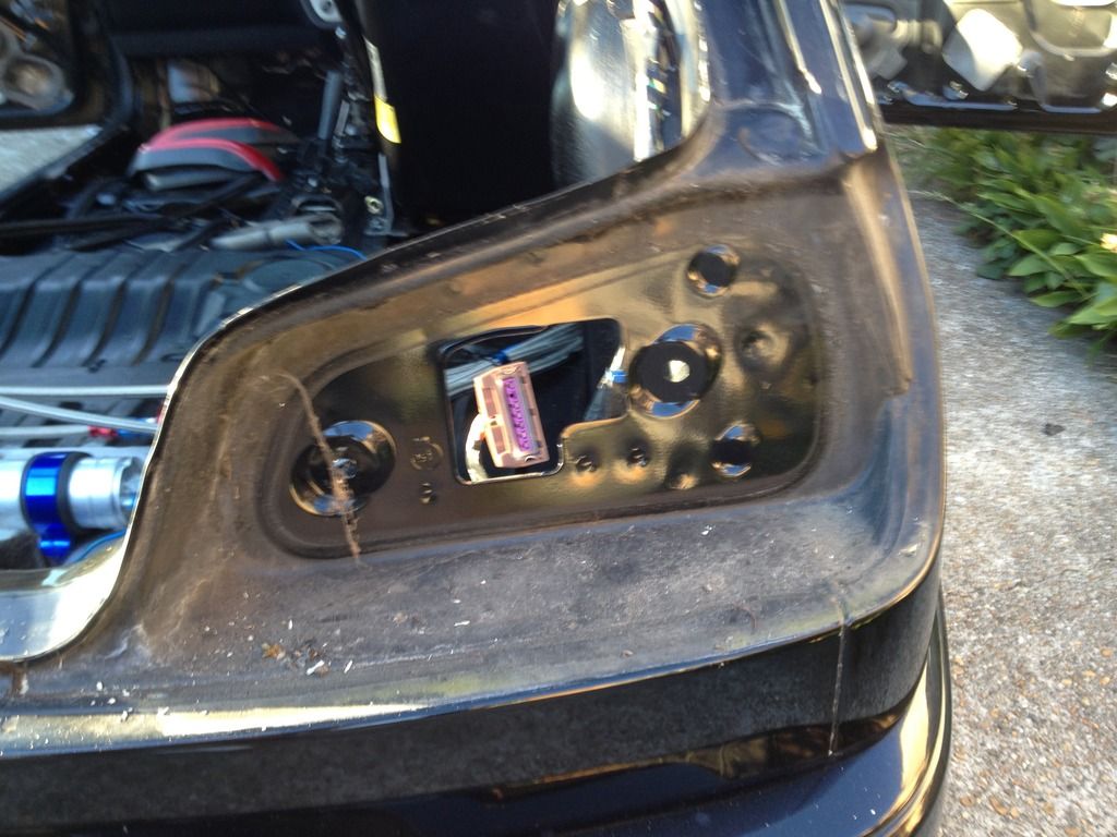

General clean up behind lights etc

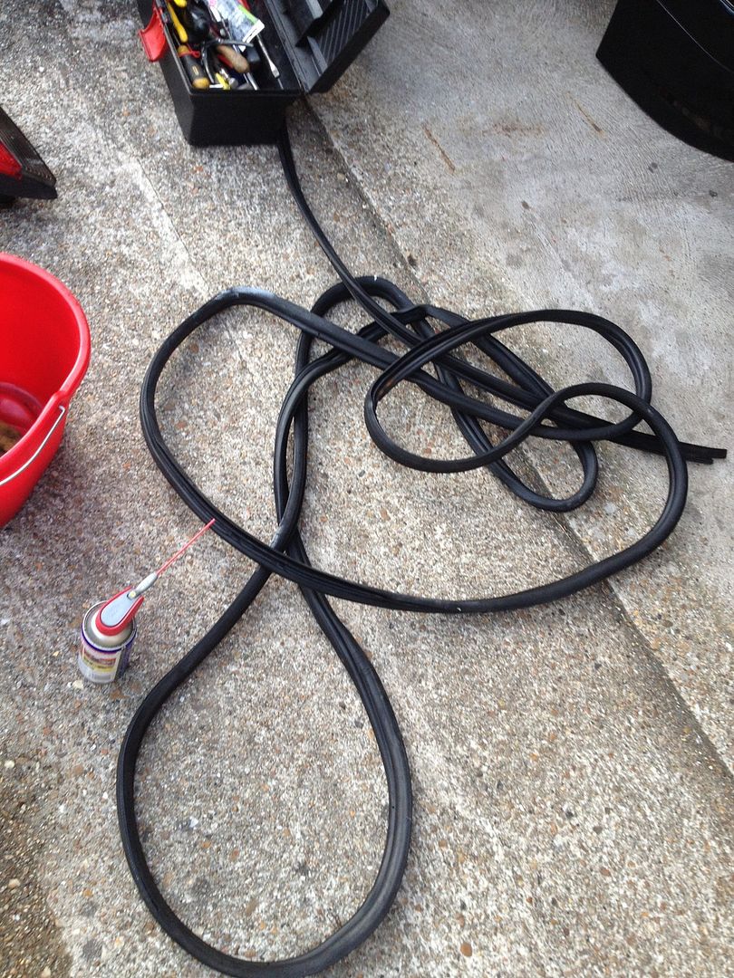

Removed all rubber seals and put them in the washing machine for a clean up

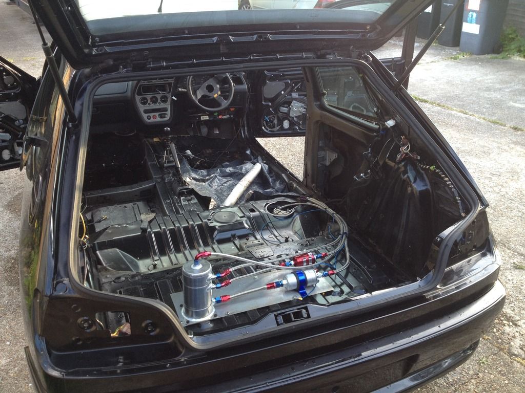

Front bumper off for a check over of the cooling systems

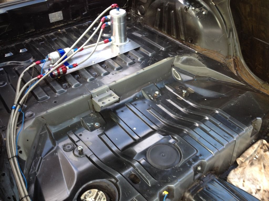

I'm probably going to relocate the engine oil cooler to one side and fit some better brackets to support the charger oil cooler. I also intend to core drill some holes in the bumper where the number plate sits.
Looking into an issue with the fuel pump wiring
Ash removing a lot of unwanted wiring
Removed expanding foam from holes where fuel pipes go through the floor
These are going to be re-routed and proper bulkhead fittings will be used.
Lights back in and rubber seals all reffited, I do like the clean simple look of the back of this car
A good day of progress with the interior & wiring, all the hard work with a hangover took its toll, poor soldier Roll eyes

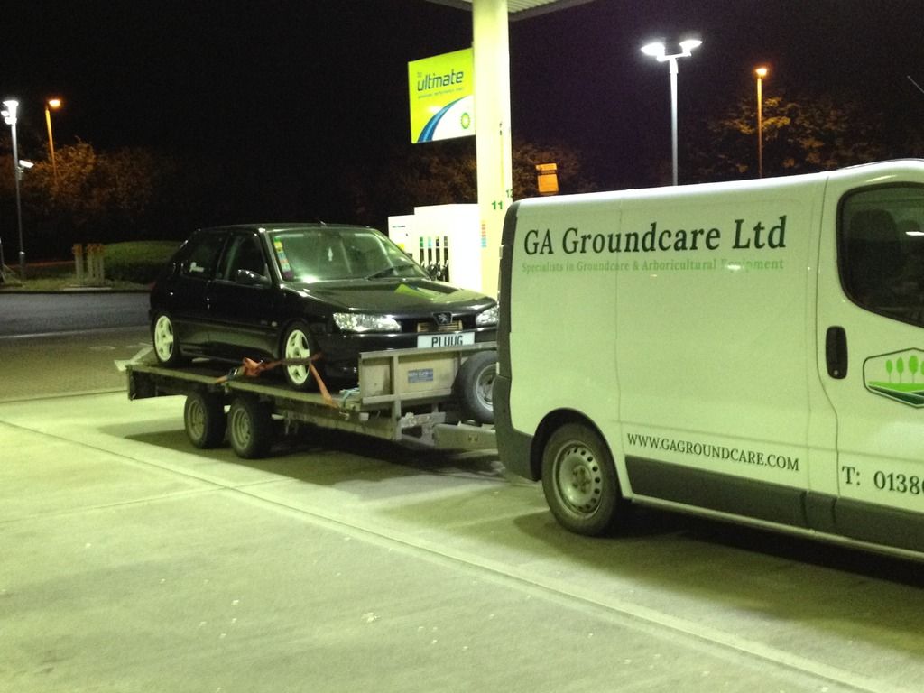

All packed up ready to be trailered to Ash's workshop to have the cage mounting points and seat frames welded this weekend

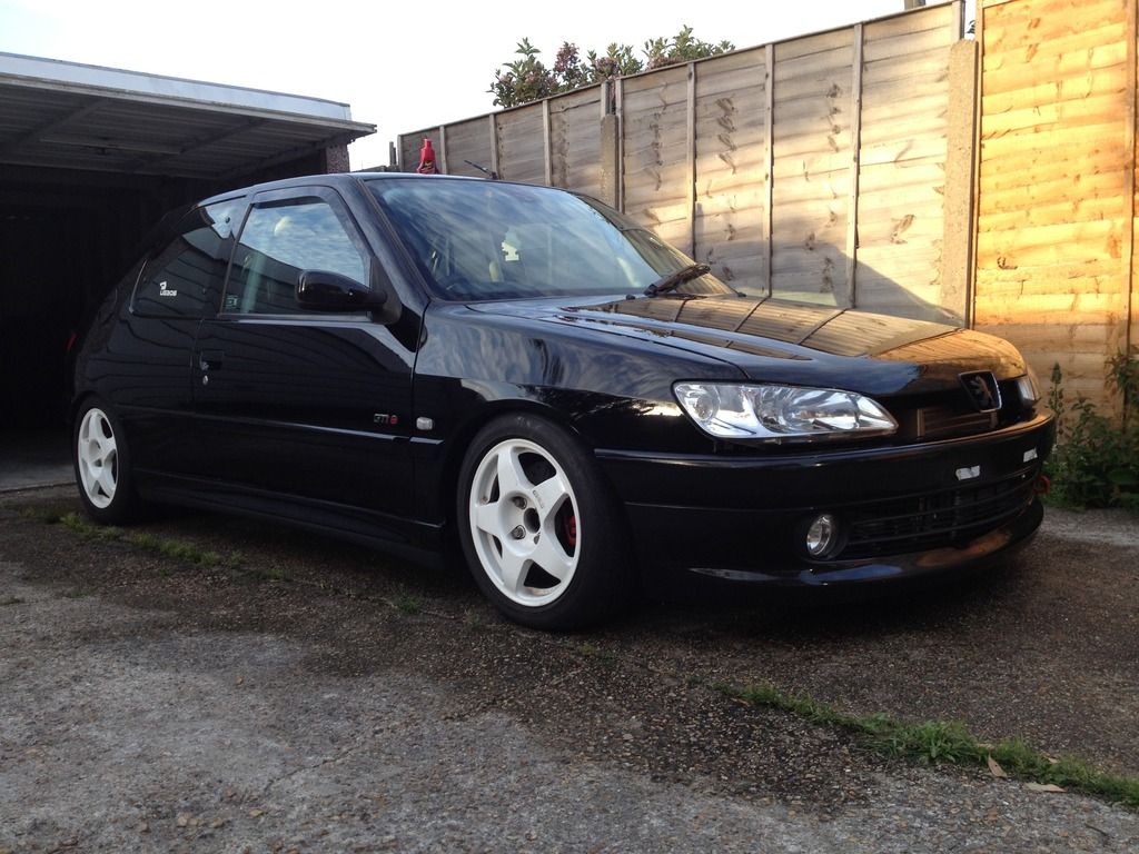

Looks a tidy track car. I do like the white pro race 3s on a black 6

Thanks mate, it is pretty tidy overall and plenty smart enough for a track car!
They're actually compomotive wheels, they look almost identical to the PR3's tho. I do like the look of them but they're quite heavy so might sell them to get some lighter ones...

Never thought of putting the seals in the washing machine. LOL

That washing machine was my top tip. I did it when I built my 205. Collecting the 306 in the morning to attack it with the welder.... Smile

The seals were like new after a 60deg 'bed & bath' cycle no 9 in the Hotpoint, obvs using Daz LOL
Looks like White Mo5s ?

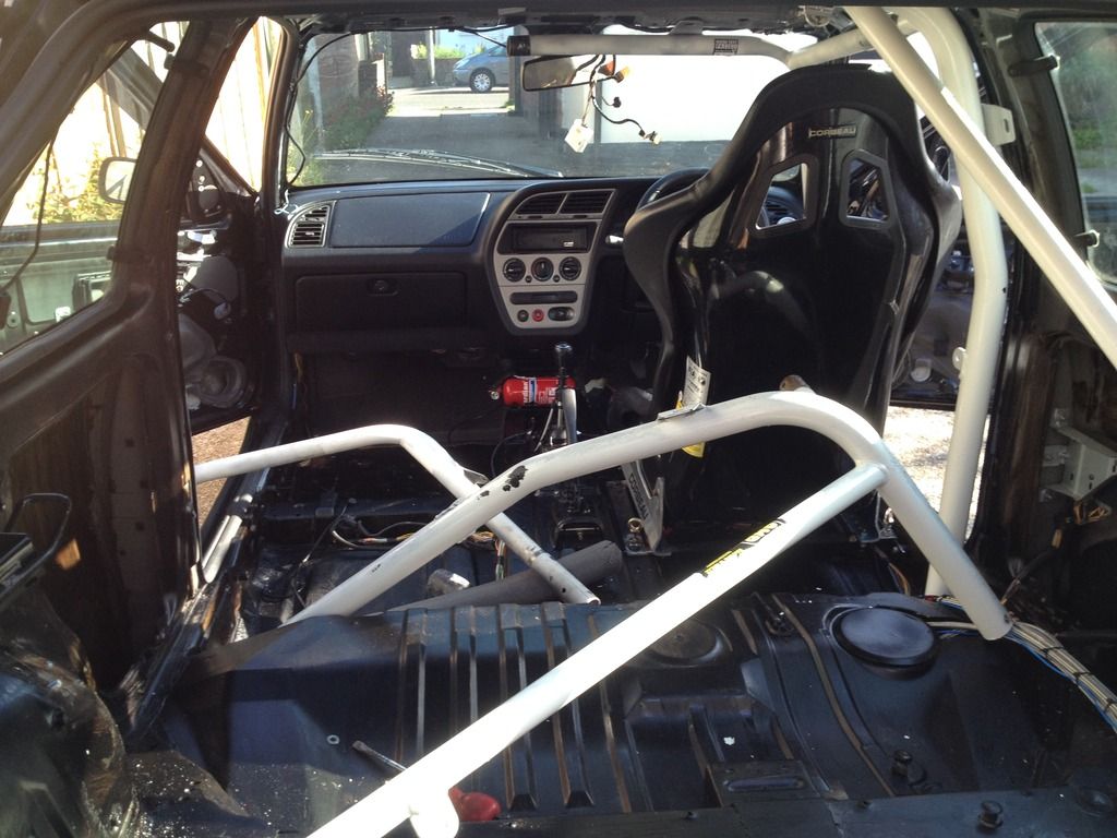

Progress...

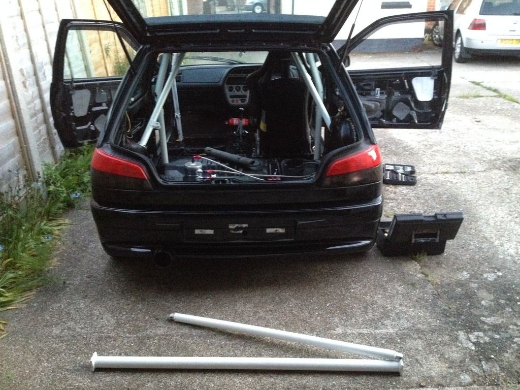

I went over to Petes on Saturday morning and brought the car back to my workshop.
As there was no foot mounts I had to make some from scratch. Can't really see from the picture but the mount also comes up the sill. Rather than just bolt the OMP cage In I felt it was easy and actually better to make it a fully weld in job.
B pillar floor mount
I also made a plate for the A pillar floor mount and welded that in too. (Forgot to get a picture)
By that time it was Saturday evening so we went and got p**ssed...
I had a few hours on it this evening, the top B pillar mount is miles away from being in the right place, nice one OMP!
So I move it and weld it in the correct place
As the rest of the cage was no longer removable I didn't see the point of bolting the rear arch mounts in, plus my arms aren't long enough to be inside the car and inside the wheel arch.
So I removed the wheel, arch liner and welded the cage in here
While I was there the old harness bar which was bolted to the wheel arches previous got chopped about and added into the roll cage
And how I left it this evening.
