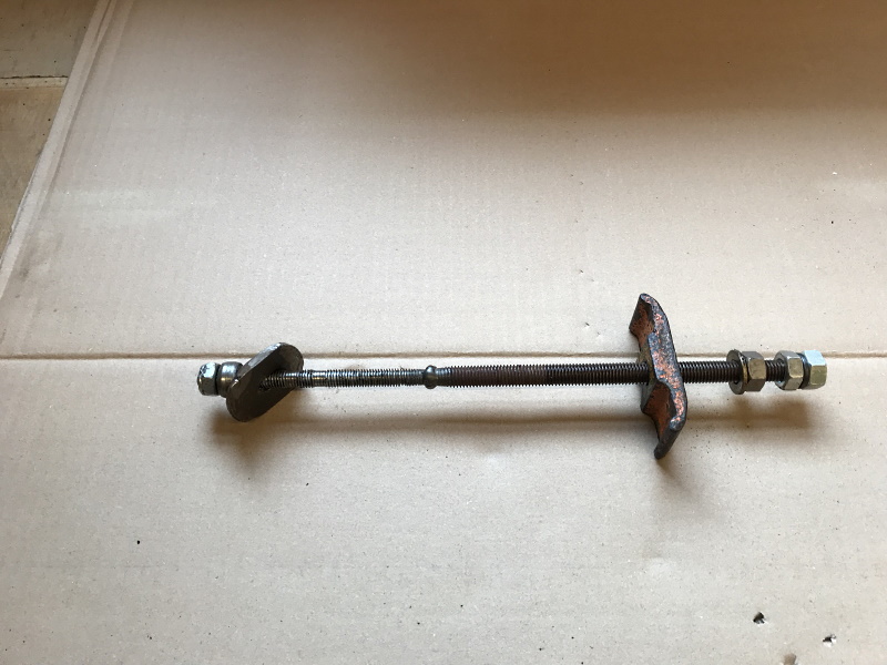

While changing rear beam bearings – made proper puller for the inner ones (m10 thread was stripping, so had to replace with M12)

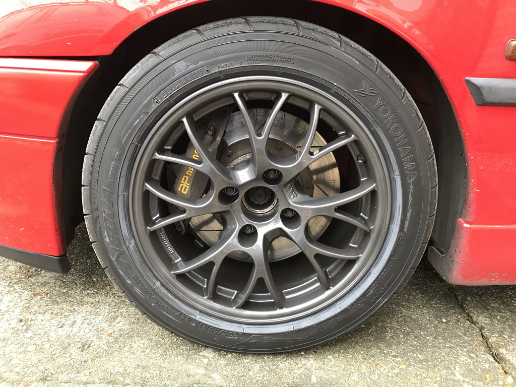

2019 Feb
Freshly refurbished Compomotive CXRs

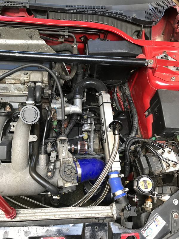

Been finding that with the normal oil cooler (oil-air) the oil was running too cold during winter. Got around to installing Laminova cooler (oil-water – similar to standard 306 cooler, just larger).
To make space for the cooler – the battery was relocated behind the passenger seat.

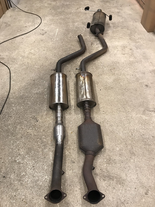

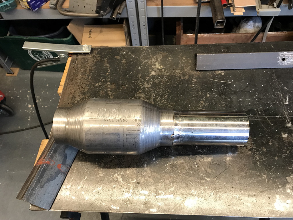

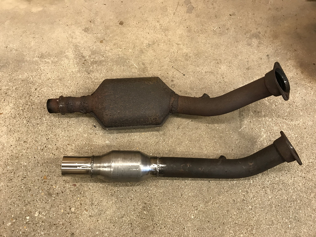

Re-built my spare Blue Flame exhaust to make sure that it is 2.5” all the way through. It had several points where it was narrowing down closer to 2” (at the joints). Also took the opportunity to build a sports cat from a spare de-cat and Magnaflow core.
For welding used my MIG welder (308 wire and Arg/CO2 mix).

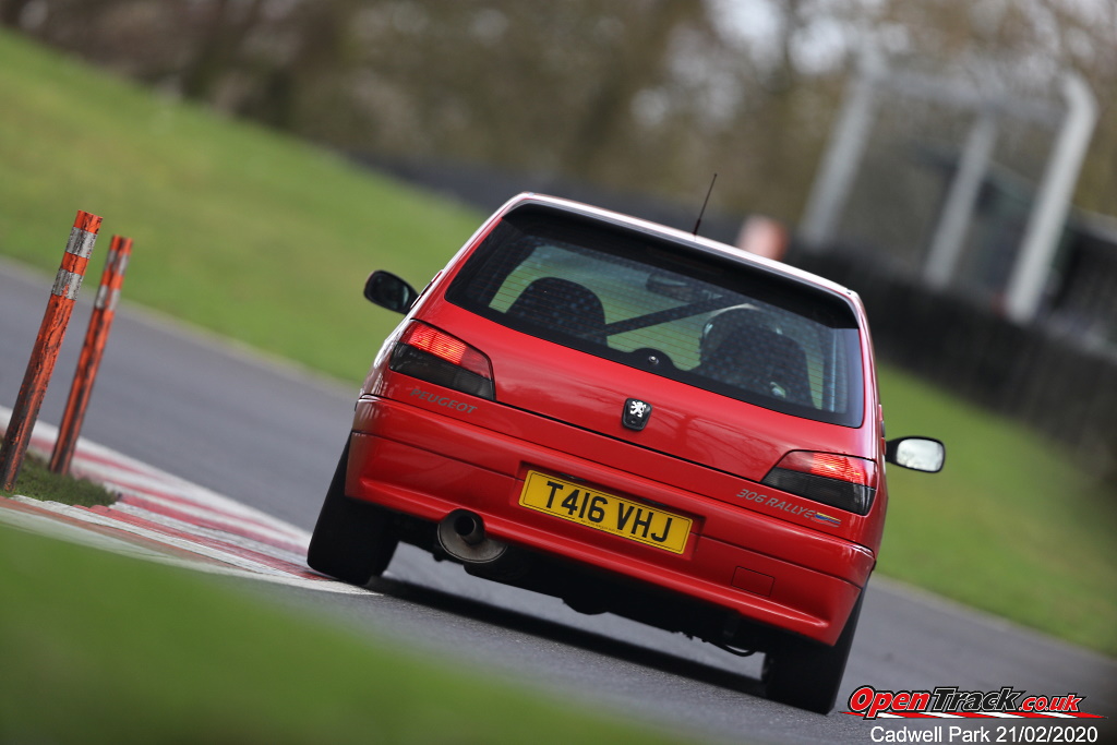

2020 Feb
Outing to Cadwell park, just before the pandemics

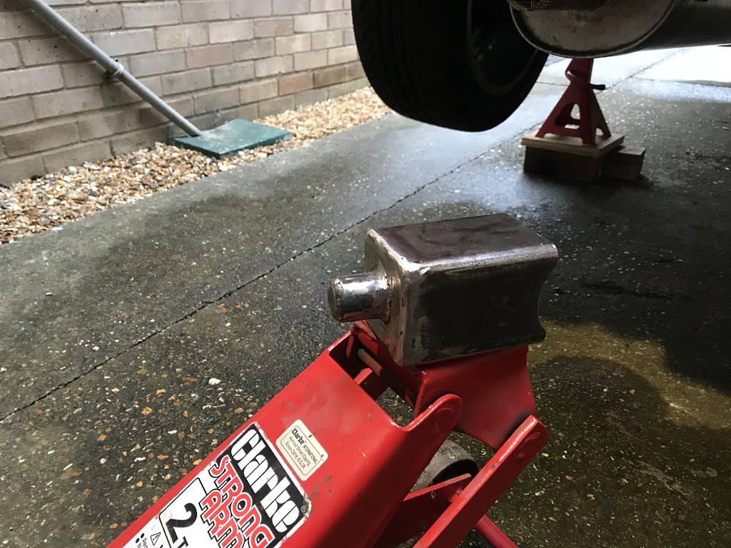

When doing work on the back of a 306 – I find it easiest to lift it on the beam tube. As it is a fairly high - I made a new saddle for my jack to utilise most of its travel:

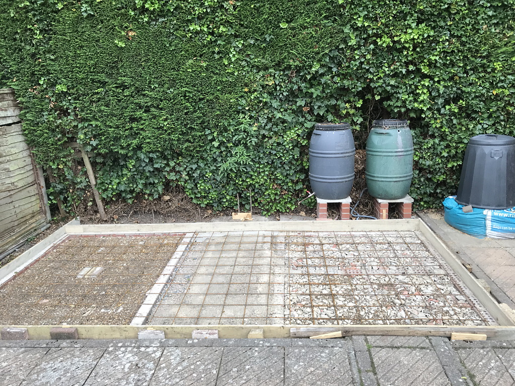

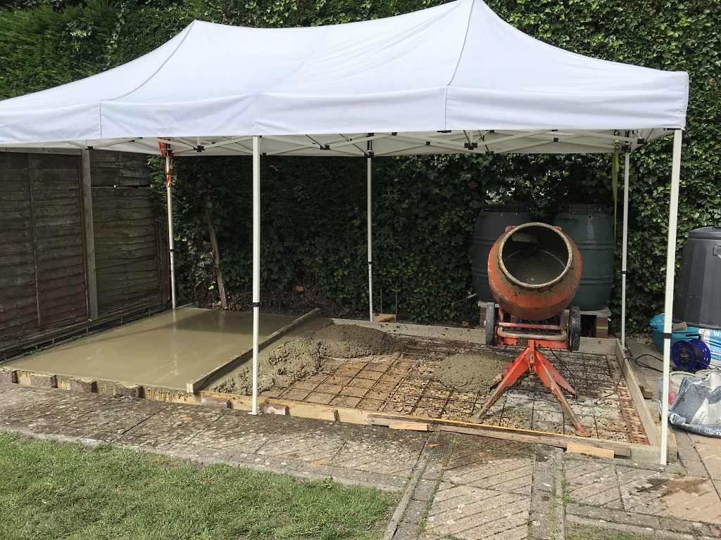

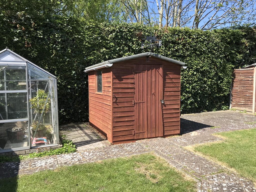

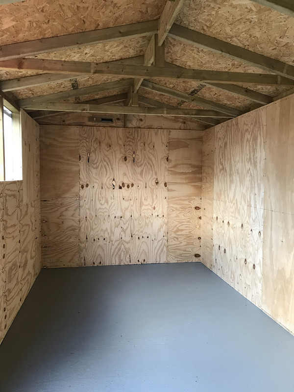

Summer 2020

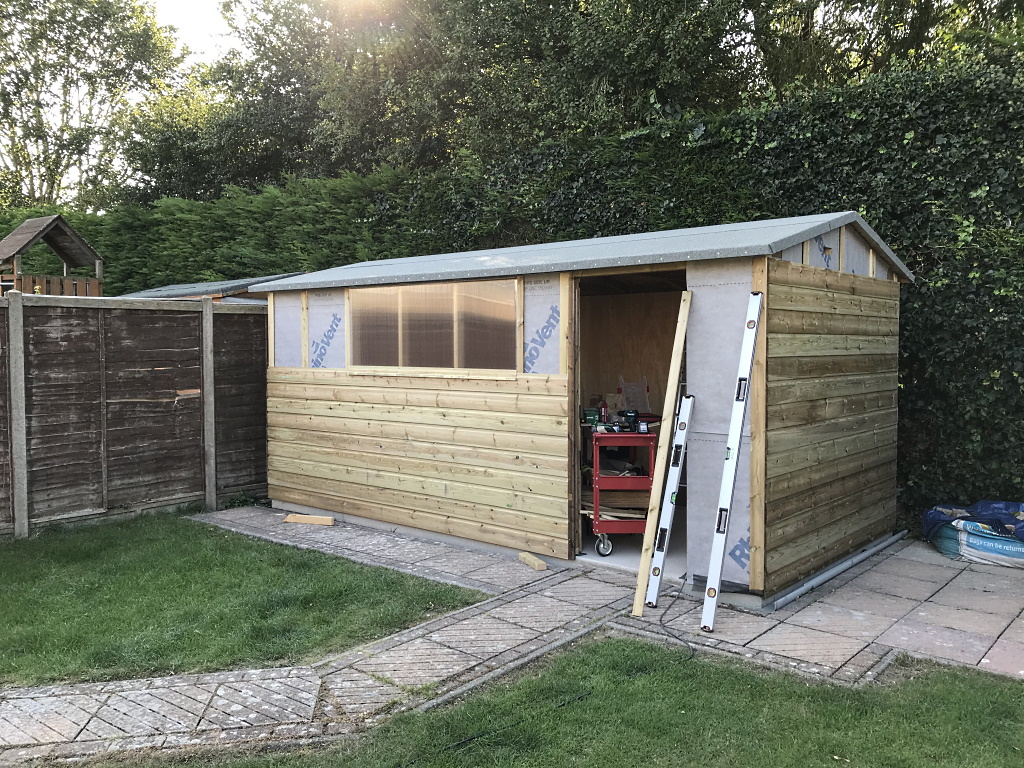

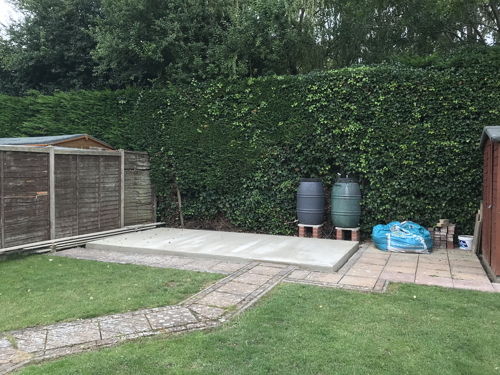

Even though the car looked good in the pictures, up close most of the panels had issues and the lacquer started to lift on the roof. Plus, usual rust issues meant that I decided to tidy up the shell. However, there was no space in the garage for all the parts that needed to come off the car.
So, decision was to re-arrange the garden and put in a 16x8 storage shed.
After a bit of market research: all the usual sheds were badly made and expensive for what you get. Solution was to design and build my own.
Shed – some self-assembly required Smile

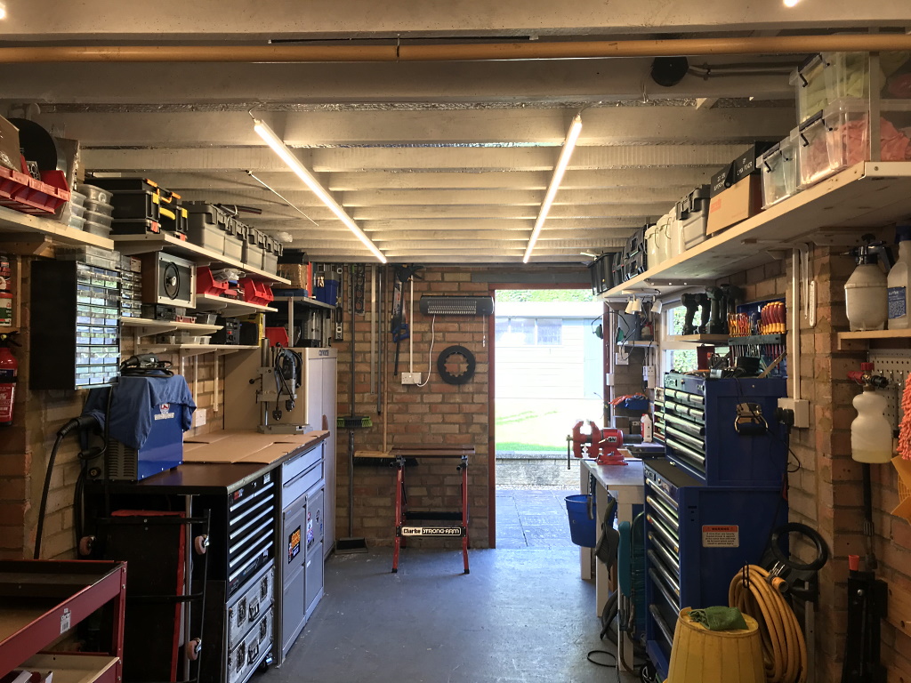

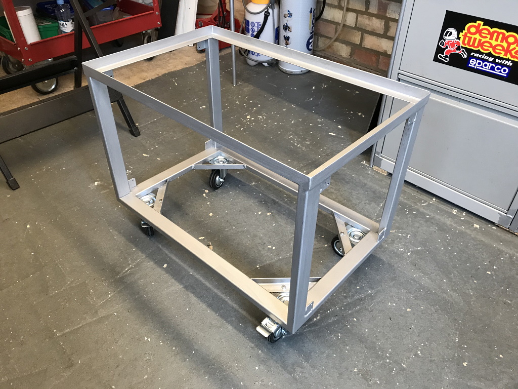

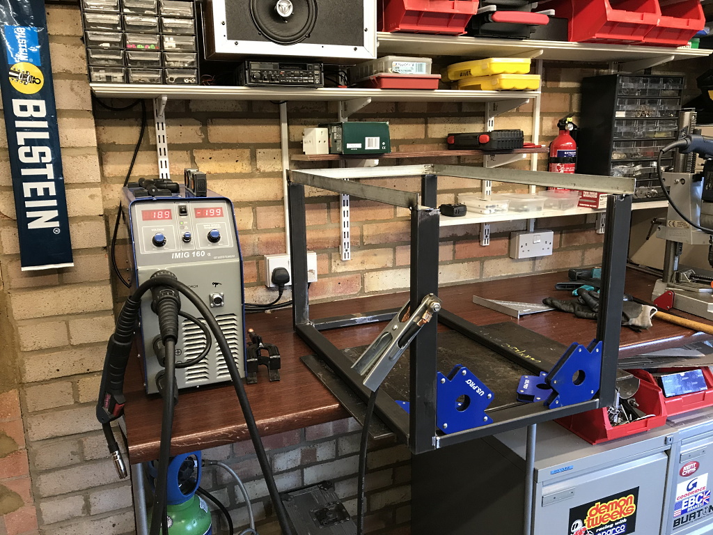

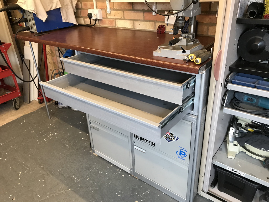

Next was to re-organise the garage and arrange some storage space.
I had some old storage cases that appeared to be not very useful, but made excellent drawers (and base for Halfords toolbox)
Some more drawers to utilize space under the workbench.

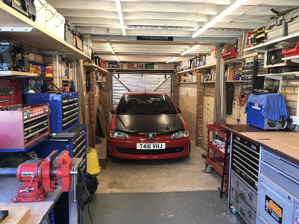

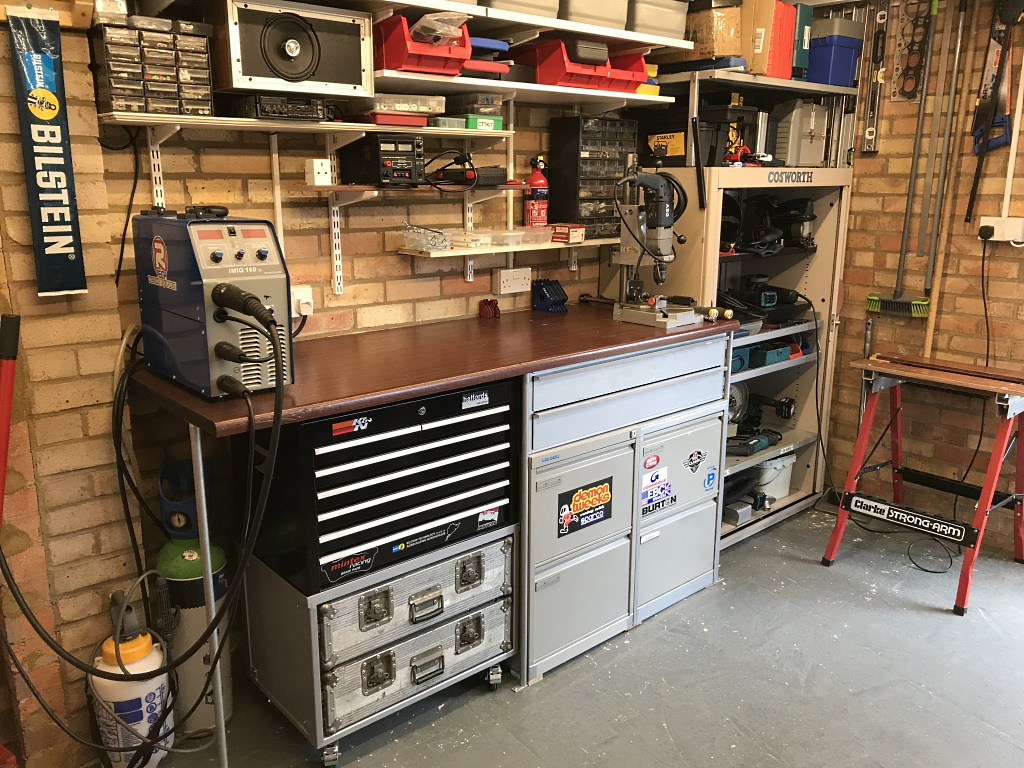

Garage ready for work on the car to start Smile
So much better to have inside space to work on the car. mine got ruined being sat on a damp drive for 6 year while we did up the last house. Bodywork on mine isnt good now and had to do a fair bit of welding on it with more to do at a later date.
Since moving and having proper garage space, I've actually enjoyed working on the car again and getting back out on the trackdays etc. Such a difference not having to depend on weather and "pack up" tools etc half way through jobs.
